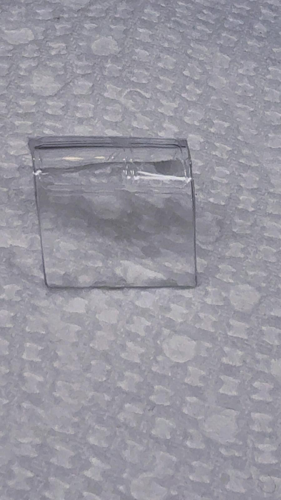

    I was at a place in the build where I thought I could paint the bottom of the plane. I sprayed the bottom with an initial layer of Tamiya Neutral Gray, then took the leftover paint and added some white and a bunch of thinner to create a slightly lighter shade. I sprayed this in random patterns along the line of airflow. I was looking for subtle, so it is a little hard to see.
    Before I painted the top, I needed to get the glass installed. I started by painting the inset area behind the cockpit with an anonymous Tamiya dark drab color, then painted the fuel fillers red. It was time to add the glass. The kit clear parts were very clear, so I had high hopes for the glass. You have a choice of a one-piece canopy to cover everything, or the separate pieces that will allow an open canopy. This is where the trouble started. Clear plastic is always a little brittle, but this ancient glass was in the very brittle range. Apparently the years were not kind. All of the canopy pieces were attached to the sprue with very large attachment points. I wanted to be safe, so I planned to clip sprue for the one-piece canopy about 1/4" away from the canopy. When I clipped the sprue, it also took a sizable chunk out of the canopy. Totally unrepairable, so I switched to the movable canopy. Again, I wanted to play it safe, so I decided to use a micro-saw to remove the canopy from the sprue. What I should have done was cut the sprue away from the canopy, but I figured it was safe to cut next to the canopy. When I got done, I realized the saw was scoring the side windows of the movable canopy. 30 minutes of progressively finer sanding stick, followed by polishing with my T-shirt, then polishing with car polish, then a dip in Future. I think it is OK now. I will face the newly polished part tomorrow, as well as the rest of the glass tomorrow. Cheers.
