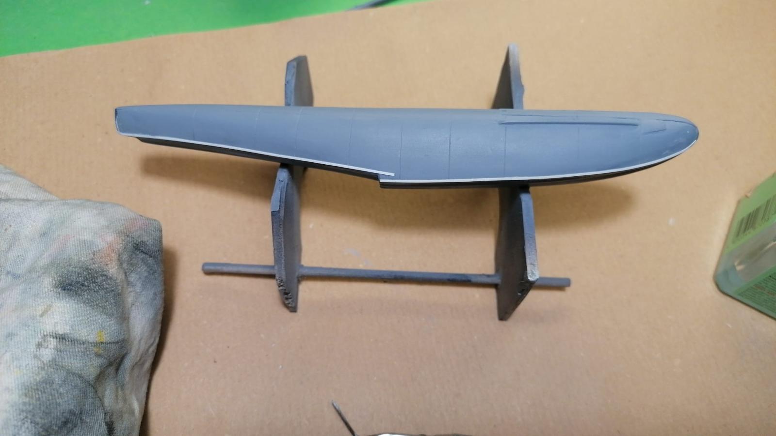

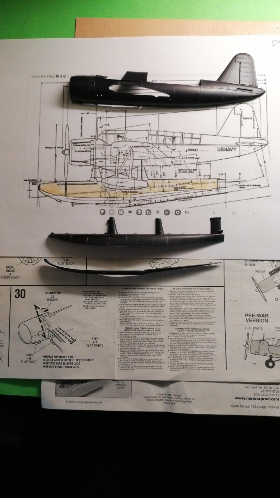

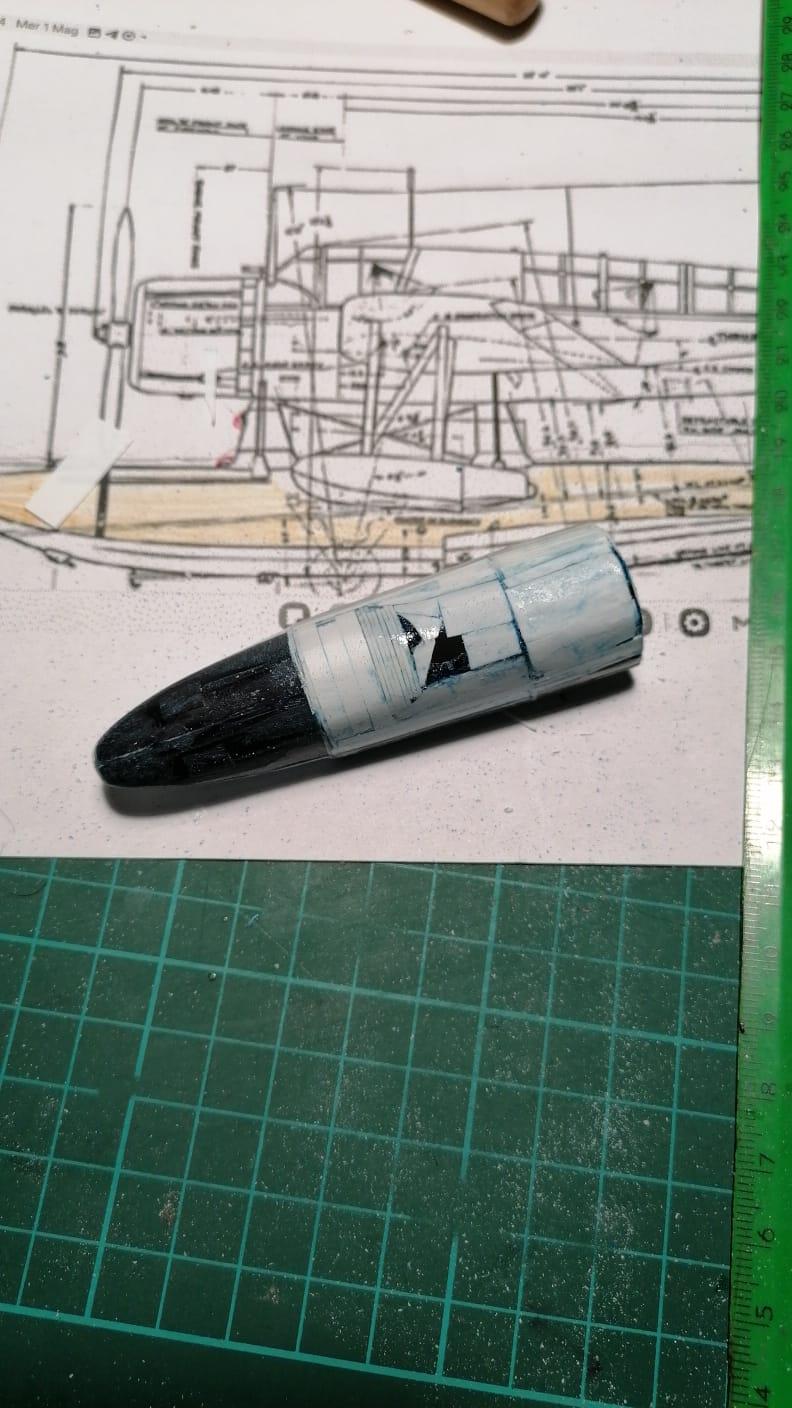

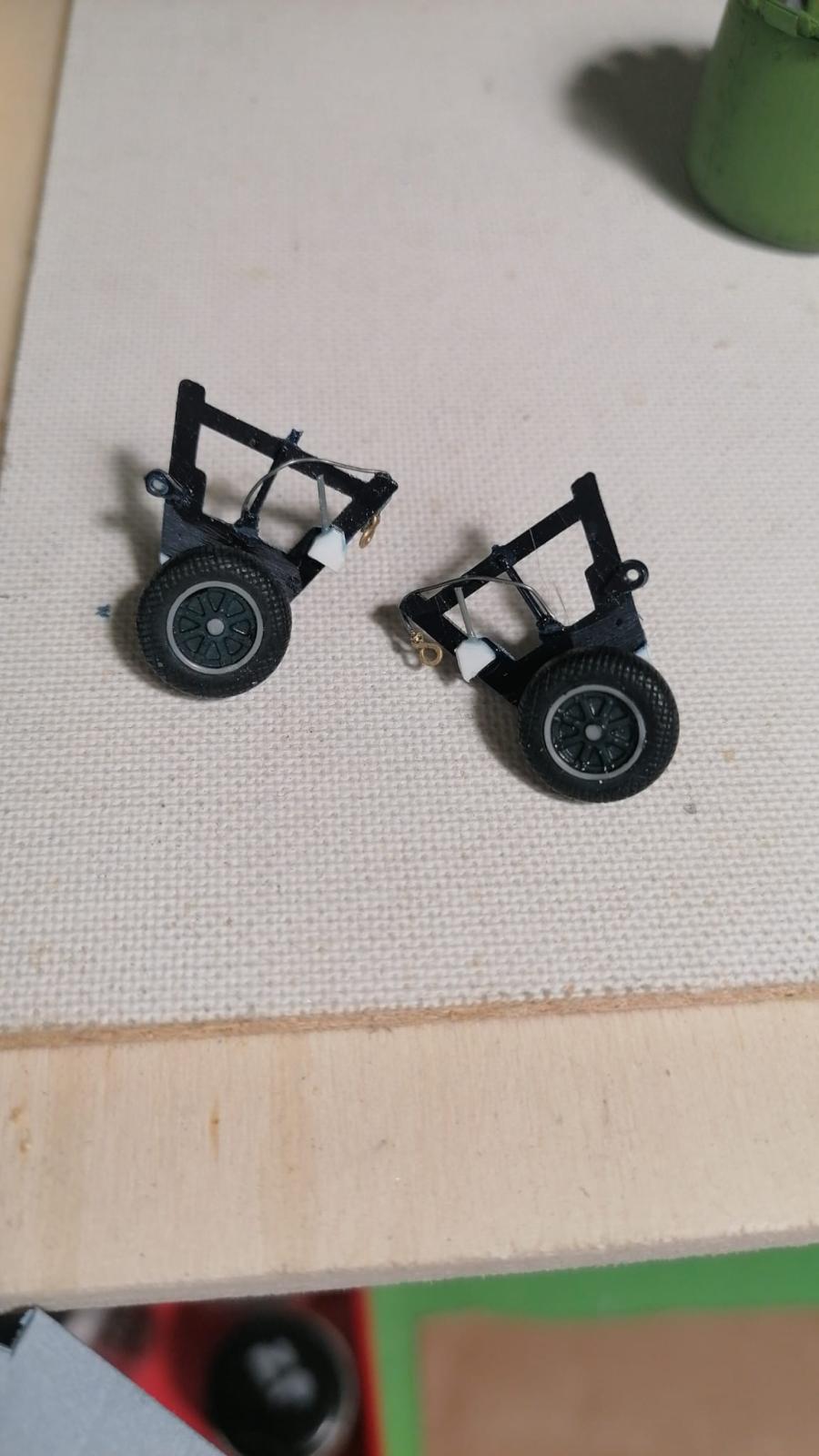

    hello everyone, I'm working on building a monogram kingfisher in 1/48 scale.
    the total reconstruction of the main float required a lot of work but it was also a lot of fun, I think that self-construction is an important part of our hobby.
    soon I will publish some photos of the progress of the work.
