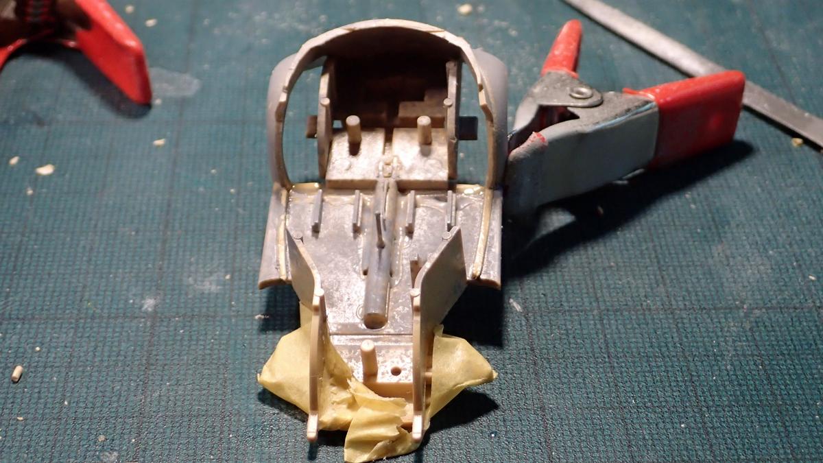

    Getting there?
    Been testfitting like a madman today.
    I really think I am close to have the fit where I want it (!) At least that is my opinion that I will not get it to fit any nicer with the skills and tools I have right now.
    The rear part needs to be widened (indeed the whole chassis need to be widened on these kits), so it is placed under pressure overnight.
    Now, the enginehood is something to discuss. In my VW bookazine it looks like the hood is the same as in the “Kastenwagen”, but the pictures online shows the two I found to have what appears to be the normal hood.
    The CMK conversion offers a new hood and an access hatch from above. That looks like the real deal to me, and I suspect the online versions are later conversions of beetles? (They also have same-size wheels wich I may borrow for this project)
    as always comments and views are welcome. The more the merrier!
